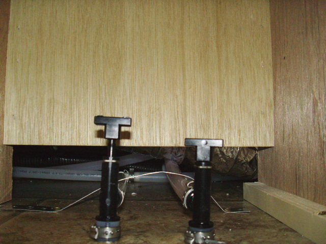

Kirk W Posted January 28, 2016 Report Share Posted January 28, 2016 Nearly all modern RVs have drains for the fresh water lines somewhere in the system today. They are valves of some type that allow the draining of the water from the plumbing lines, in addition to the drain for the fresh water tank and the one for the water heater. They are usually found under teh RV and may be just drain lines from a valve located inside of the RV or they might be valves or caps on the lines. Usually there are two, one for hot water lines and one for cold water lines and they are usually red for hot and blue for cold. The first image is one that has caps on the outside while the second image is of rubber lines that come out from valves that are found up on the inside of the RV and which should look something like one of these next images. Link to comment Share on other sites More sharing options...
