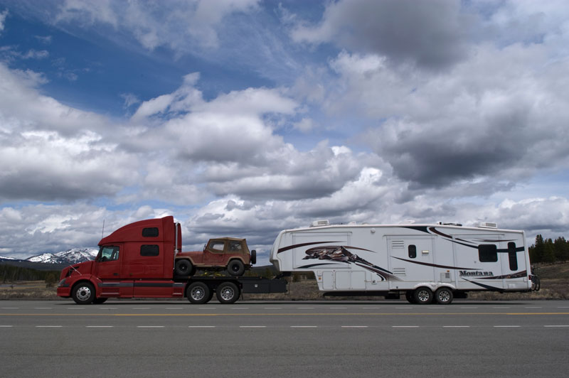

RickW Posted April 14, 2016 Report Share Posted April 14, 2016 I haul a Jeep Wrangler on the truck bed with a 40ft trailer. If you can get a 40ft Diesel pusher in to a site I have no problems getting the trailer in. With the hitch as far back as I have it, it makes the trailer very responsive when backing in to a site. 2017 Entegra Anthem 44A SOLD - 2004 Volvo 780. 465hp and 10sp Auto Shift (from 2010~2017) SOLD - 2009 Montana 3400RL Link to comment Share on other sites More sharing options...
SPEENO Posted April 14, 2016 Author Report Share Posted April 14, 2016 Hi Rick, your rig was the one I saw on the internet that gave me the inspiration. How long are you overall? Link to comment Share on other sites More sharing options...
GlennWest Posted April 14, 2016 Report Share Posted April 14, 2016 My best guess is 36'. When Rick post back we will see 2003 Teton Grand Freedom towed with 2006 Freightliner Century 120 across the beautiful USA welding pipe.https://photos.app.goo.gl/O32ZjgzSzgK7LAyt1 Link to comment Share on other sites More sharing options...
SPEENO Posted April 14, 2016 Author Report Share Posted April 14, 2016 Hi Glenn, you think the toter is 36' then overall about 74'?0 Link to comment Share on other sites More sharing options...
GlennWest Posted April 14, 2016 Report Share Posted April 14, 2016 One needs 60" clearance for turn radius of coach. I used a full length frame and am just shy of 30'. His jeep takes up what appears to be stock rails. So best guess is 5' added. So 35-36' my guess. Let's see if I win the prise. Lol If you search Rick been asked this a lot. 2003 Teton Grand Freedom towed with 2006 Freightliner Century 120 across the beautiful USA welding pipe.https://photos.app.goo.gl/O32ZjgzSzgK7LAyt1 Link to comment Share on other sites More sharing options...
RickW Posted April 15, 2016 Report Share Posted April 15, 2016 One needs 60" clearance for turn radius of coach. I used a full length frame and am just shy of 30'. His jeep takes up what appears to be stock rails. So best guess is 5' added. So 35-36' my guess. Let's see if I win the prise. Lol If you search Rick been asked this a lot. Sorry Glenn no prize for you today. My total length is 33'. With the shocker ball hitch installed I am 34'. The original frame rails were 12' back of cab to end. I added another 6' of frame. The actual bed is 17' 5" (just measured this morning by another considering his options here at the ECR). From the back of the Jeep (Spare Tire) to my pin is 44". No I can not do a jack knife. In 6 years that has never been a issue. I can also pick up some space by removing the spare tire off the Jeep. With the hitch so far behind my rear axles the trailer turns on a dime. My original Jeep (the red '87) was about 6" shorter than the one we carry now (white '14). I do have a few scuff marks on my cap from the spare tire. I keep telling myself I am going to relocate the spare on the Jeep. 2 years and counting. Hopefully I will get around to it before I replace the Jeep. But as you can see the problem is no so severe that it is on the top of my list. It is not causing damage but I do need more space between the Jeep and trailer. 2017 Entegra Anthem 44A SOLD - 2004 Volvo 780. 465hp and 10sp Auto Shift (from 2010~2017) SOLD - 2009 Montana 3400RL Link to comment Share on other sites More sharing options...

les_garten Posted November 9, 2016 Report Share Posted November 9, 2016 Sorry Glenn no prize for you today. My total length is 33'. With the shocker ball hitch installed I am 34'. The original frame rails were 12' back of cab to end. I added another 6' of frame. The actual bed is 17' 5" (just measured this morning by another considering his options here at the ECR). From the back of the Jeep (Spare Tire) to my pin is 44". No I can not do a jack knife. In 6 years that has never been a issue. I can also pick up some space by removing the spare tire off the Jeep. With the hitch so far behind my rear axles the trailer turns on a dime. My original Jeep (the red '87) was about 6" shorter than the one we carry now (white '14). I do have a few scuff marks on my cap from the spare tire. I keep telling myself I am going to relocate the spare on the Jeep. 2 years and counting. Hopefully I will get around to it before I replace the Jeep. But as you can see the problem is no so severe that it is on the top of my list. It is not causing damage but I do need more space between the Jeep and trailer. Hi, I am looking over rigs to carry a Wrangler with HDT and 40 something trailer and found your posts. The overall length for the current Wrangler is 13.7' or 164" What is your Overall rig length now? I was considering my options, One is like how you did it. I don't want a TOAD config behind the Trailer But... I'm thinking of the Semi based 57' Spacecraft with 15' of Garage on the back. I thought most folks singled their rigs to save weight, cut down on axle Tolls, and that it was easier to be registered as a Motorhome. As well as move the axle to Fifth Pin location. But you didn't single yours? What are the advantages/disadvatages to not singling the rear axle? How much more would Toll roads be with the extra axle? Does it matter for tolls if the extra axle is on the trailer or tractor? <<Les Garten>> Link to comment Share on other sites More sharing options...
