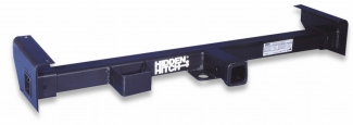

I installed a receiver hitch similar to this one on Arctic Fox TT. I had the side to side adjustment welded and then bolted it on.
